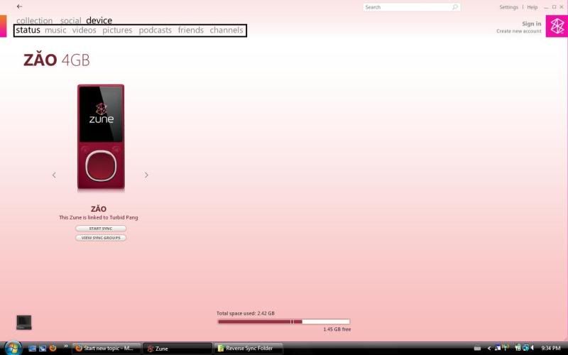

3. Click on either the Device tab at the top of the software or the Zune symbol circled in the previous picture.
4. Once in the Device section of the Software, head to the appropriate media type you which to reverse sync by clicking on the appropriate tab at the top of the Software.

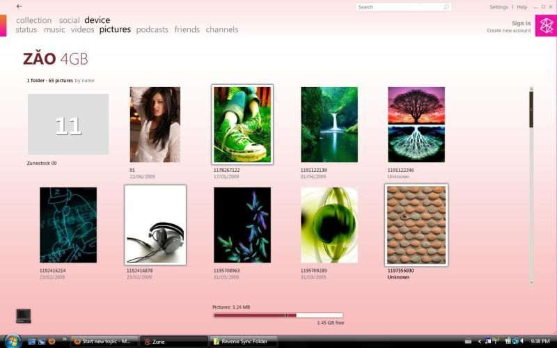

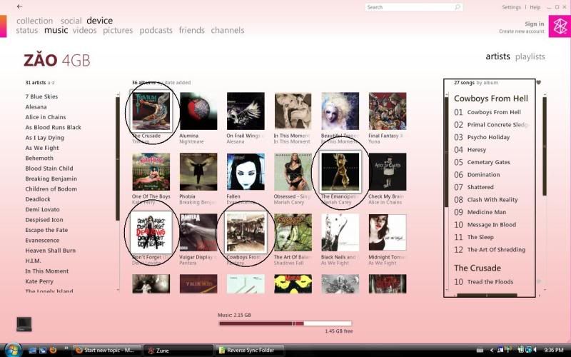

5. After clicking the appropriate tab, select the media in which you wish to reverse sync. If you wish to reverse sync all of the specific media type, click on one item and press ctrl + A.
Music
Photos

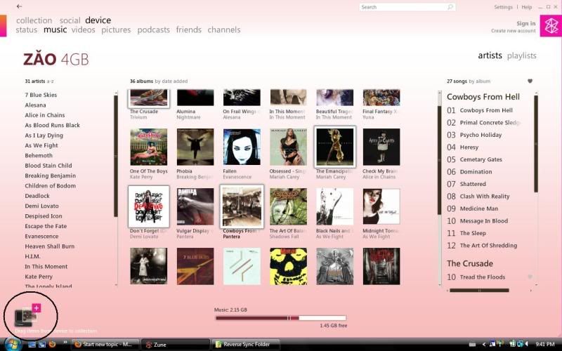

6. After selecting the media in which you would like to reverse sync, drag those selected items to the computer icon at the bottom left corner of the software.

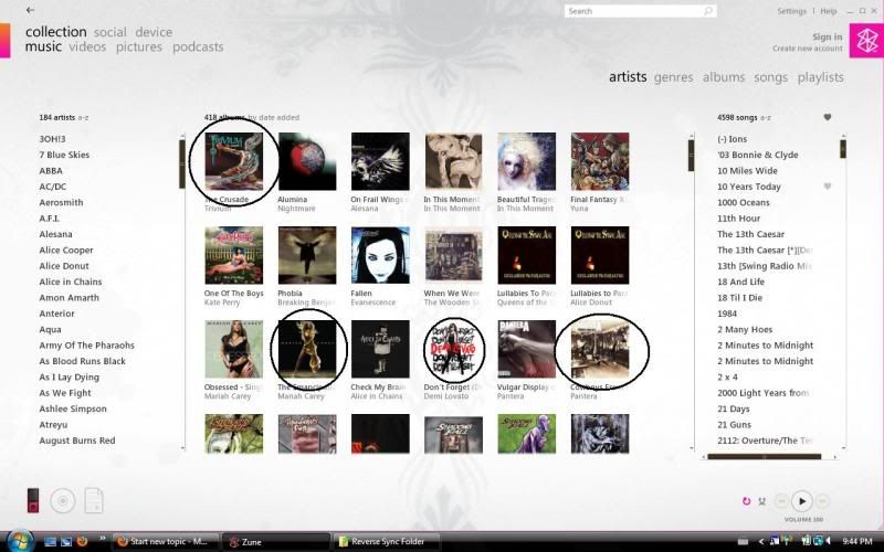

7. Your media should appear in it's proper section of the Zune software now.
8. The music will appear in the folder on your computer where your ripped CDs are showing up. All other forms of media will appear in a "Received Pictures" or "Received Videos" folder.
